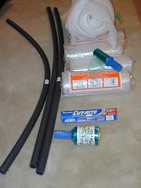

Materials needed:
Wax paper
Cellophane wrapping tape (available at U-Haul, Staples, and other places, and Saran wrap can also work).
Foam pipe insulation
Bubble wrap
Optional other padding such as foam, cardboard, carpet, etc.

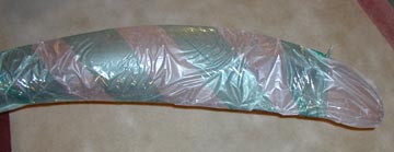

Step #1
Cover the blades with wax paper and loosely hold down with cellophane wrap.  This protects the varnish and prevents abrasion or sticking, especially on the decals.

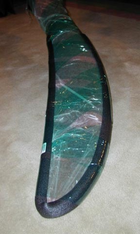

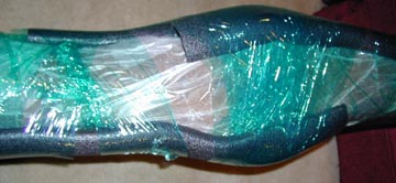

Step #2
Split the seam in the foam pipe insulation and spread the edges over the leading and trailing edges of the propeller.  Again, all you need to do is just hold it in place with the cellophane wrap.  The trailing edge is usually the thinnnest and the most vulnerable.
Step #3
Additional short foam pieces can be added around the hub.  Don't bother wrapping a lot of cellophane in these steps.  Save it for the final wrapping.

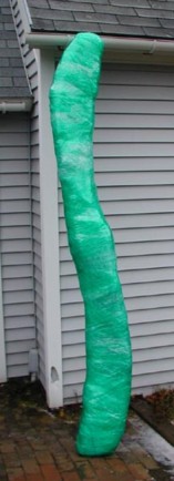

Once the bubble wrap  and any other padding is in place, go ahead with the cellophane wrap and just tighten it up and secure it.  This forms a "skin" around all of the packing material.
Step #5
After 3 or 4 layers of bubble wrap have been applied, use the cellophane wrap to create a "skin" holding the bubble wrap and other protection in place.  Some packing tape will help hold the end of the cellophane wrap down, but very little is needed here, and using it sparingly makes unwrapping it much easier.
A "fragile" sign from the shipper may help alert the handlers to be a little extra careful, but the package is quite well protected this way.
